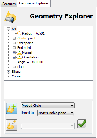

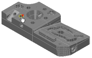

You can create items by selecting the features directly from the CAD model. This example demonstrates how to create inspection items for the two probed circles used in the alignment. The centre of the first circle is used to determine the origin of the alignment. The centre of the second circle is used to construct a line in Stage 5.

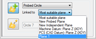

To create two probed circles:
.The circle is added to the inspection sequence.

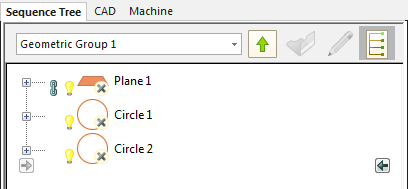

Notice the symbols shown alongside the items you have added to the inspection sequence.
indicates the item is unmeasured.
indicates the item is displayed in the CAD view.
indicates the item is used by other items in the sequence. You cannot delete a referenced item until you have deleted the items that use it.
