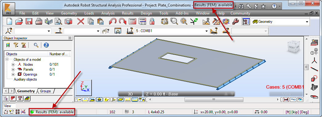

  2. Click (Analysis Calculations).
    The calculation process starts. The Calculations dialog shows the advancement of the process, which depends on the size of the project being analyzed.
  3. Once the calculations are complete the information: Results (FEM): available is displayed at the top and the bottom of the program.
  4. Save the project as Plate_Analysis.rtd.
