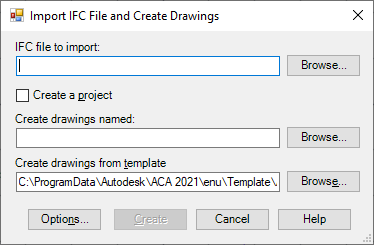

Use this procedure to import an IFC file. When you select an IFC file to import, you specify whether to create the drawings in an AutoCAD Architecture 2021 toolset project or as a set of standalone drawings.
  1. Click Open IFC (Industry Foundation Classes).
  2. In the Import IFC File and Create Drawings dialog box, click Browse for IFC file to import, navigate to the desired IFC file, and select it.
  3. Specify if the imported file is to be part of a project:
    If you want to… Then…
    import the file and create a project and project drawings select Create a project, and enter a folder name for Create project under folder; or click Browse, navigate to the desired folder, and select it.
    The drawings are imported with the structure of an AutoCAD Architecture 2021 toolset project.
    import the file as standalone drawings enter a drawing name for Create drawings named; or click Browse, navigate to the desired file, and select it.
    Unless you specify otherwise, the drawing is created at the same location as the IFC file.
  4. If you want to change the default value for Create Drawings from Template, click Browse, navigate to the desired DWT file, and select it.

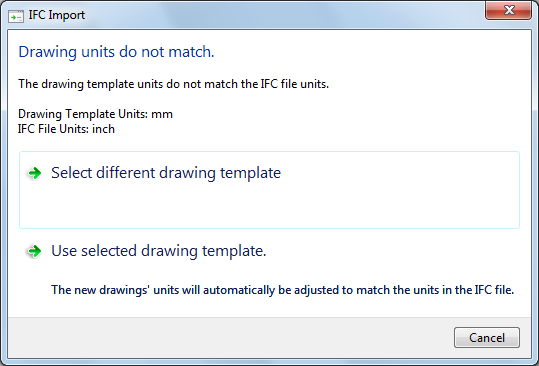

    If the template (DWT file) you select does not have the same units as the IFC file being imported, you are given the choice to continue with that template or select a different template. If you choose to continue with the selected template, the units in the IFC file will override the units in the template file.
    Note: The template you select becomes the new default template.
