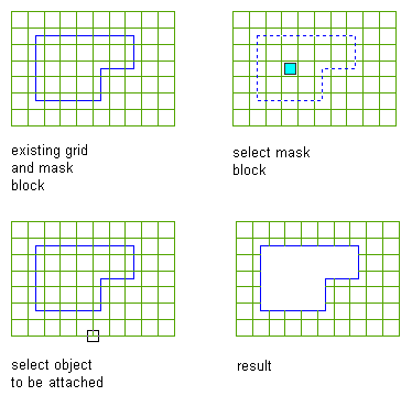

Use this procedure to mask an object by attaching the mask block to the object after you have the mask block placed correctly.
  1. Select the mask block or blocks that you want to attach to an object.
  2. Click Mask Block Reference tabModify panelAttach Objects.
  3. Select the object that you want to mask.
  4. Select a display representation from the list of current display representations, and click OK.
    Attaching a mask block to an object
The object is now hidden by the mask block.
