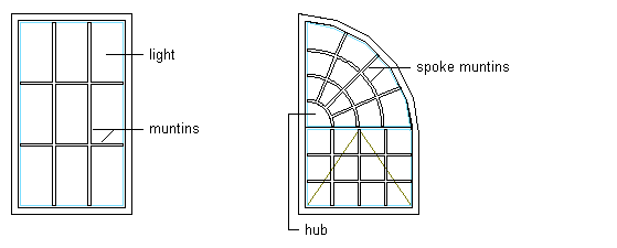

You can make custom shapes for window muntins by creating profiles from polylines and adding them to a new window style.
Window muntin components
