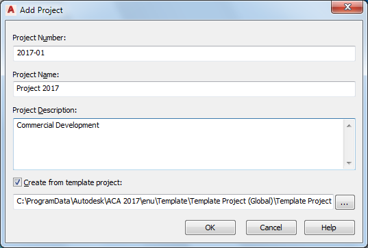

Creating a template project is not the same as simply copying and renaming an existing project. In order to properly call for a template, you must specify it at the time that you create your new project.
Specifying the template project from the Add Project dialog box. This is the only time this can be done. When the new project is created, settings and files from the specified template project will be copied to the new project.
