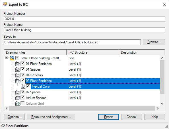

  3. In the Export to IFC dialog box, specify the following properties:
    • For Project Number, enter a project number for the drawing.
    • For Project Name, if necessary, modify the name. By default, it displays the name of the drawing being exported.
  4. Click Browse to change the default location of where the IFC file is exported.
  5. Under Drawing Files, select the drawing files to be exported.
    If you select an xref at the top level, all xrefs nested within this drawing are selected as well. Expand the top level, and select xrefs individually if necessary.
  6. If you want to change the labels for the drawing files selected, click the label in the IFC Structure column, and select a different level from the drop-down list, or enter text in the field.
    If you want xrefs to display as a distinct level within the IFC file, specify different identifying labels under IFC Structure. You can specify the same identifier, such as Level (1), for multiple xrefs to combine the objects within those xrefs into one IfcBuildingStorey.
  7. Enter a description of the file for export.
    You can select multiple drawing files and change all labels or descriptions at the same time.
  8. If necessary, click Options to specify the export options.
  9. If necessary, click Resource and Assignment to create IFC instances and define the resource properties.
  10. Click Export.
