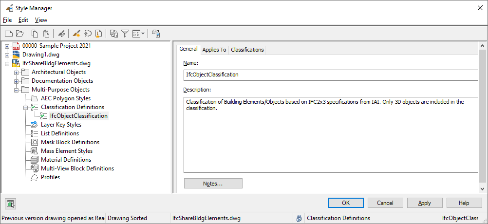

  2. Click Manage tabStyle & Display panelStyle Manager.
  3. In Style Manager, click (Open Drawing).
  4. Navigate to C:\ProgramData\Autodesk\ACA <version>\enu\Styles and open IfcPropertySet_Definitions.dwg.
  5. On the left pane of the Style Manager, expand IfcPropertySet_Definitions.dwg Multi-Purpose Objects Classification Definitions.
  6. Right-click Classification Definitions, and click Copy.
  7. Right-click the drawing into which you want to copy the style(s), and click Paste.
    The styles or definitions are pasted into the selected drawing. If the drawing already contains a style with the same name, the duplicate name is displayed in the Import/Export - Duplicate Names Found dialog box.
  8. On the left pane of the Style Manager, expand your drawing Multi-Purpose Objects Classification Definitions and select IfcObjectClassification.
  9. Click the Applies To tab, select the objects you want the classification definition to apply and click OK.

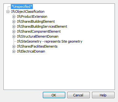

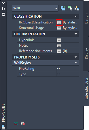

  10. In the drawing, select the objects to classify.
  11. In the Properties palette, on the Extended Data tab, under Classification panel, click IfcObjectClassification and select the classification.
  12. Click OK.
