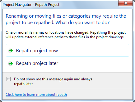

You have the choice of repathing:
The Project Navigator - Repath Project dialog box displays.
| If you want to… | Then… |
| update all project files now | click Repath project now. |
| update all project files later | click Repath project later. If you close the project before repathing, the drawing files remain in a queue for update and will display in the Project Repath Queue dialog box the next time you open it.
The repath queue is shared by all users working on a project and it is saved from session to session. |
