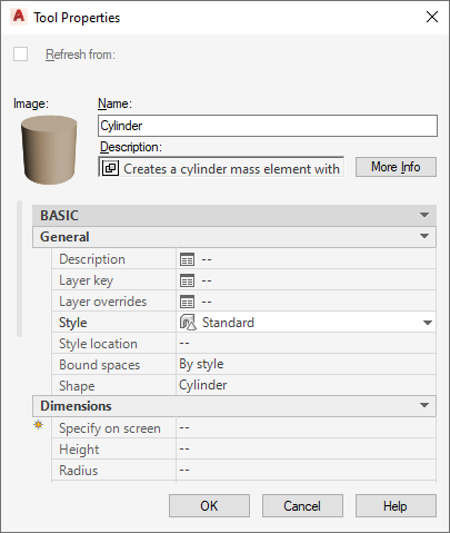

Mass Element Styles
Unlike many other types of AutoCAD Architecture 2021 toolset object types, mass elements do not have to exist on a specific mass element style to be effectively used. Many mass elements can be created on the style “Standard” with no adverse effects whatsoever. However you can define mass element styles to predefine material assignments, classification assignments and display representation overrides.
Mass Element Style Naming Conventions:
Mass - <Optional classification assignment> - <Material assignment>
Note: Classification and material assignments can be abbreviated in the mass element style name.

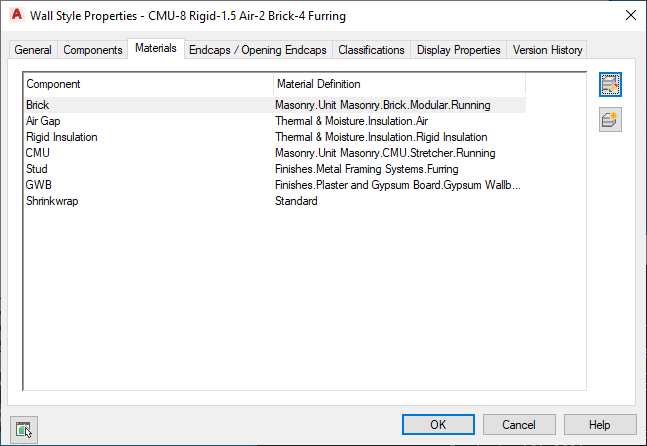

Material Definitions
Material Definitions are integral to the display system in AutoCAD Architecture 2021 toolset and are a powerful tool to use with style and object definitions to automate displays in plan, section and elevation. Additionally, you can use a “Material” automatic property definition to tie material assignments (and the properties of those materials) into a schedule table of objects that have the materials assigned to them.
Material Definition Naming Conventions:
<General material category>.<Additional descriptive field>.<Optional additional descriptive field>...<Optional color>
Example Material Definition Names:
Material Definition Description Example Name
Cast in place concrete, exposed aggregate, medium texture. Concrete.Cast-in-Place.Exposed Aggregate.Medium
Dark green marble flooring tile. Finishes.Flooring.Tile.Marble.Deep Green
Best Practices for Material Definitions:
Attention: If you want to use material definitions to control the display of object components in a 2D Section/Elevation object on the cut line you must first set the “Defining Line” component in the 2D Section/Elevation’s “General” display representation to “By Material”. Next, edit the material definitions being used in the section and set the “2D Section/Elevation Linework” component to the color, line type, line weight and plot style you would like to see in the Section/Elevation. You will also need to make sure the setting “Maintain layer, color, linetype properties form the Display Set used during generation” is toggled off.
