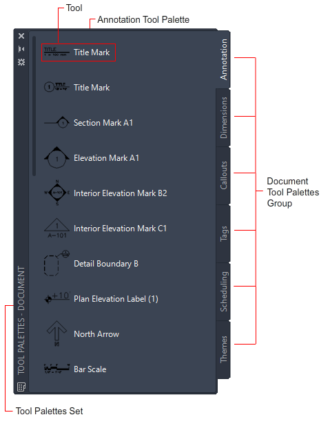

Tool palette components
Tool palettes sets contain groups of tool palettes. You can rename the default tool palettes set or create a custom tool palettes set. Additionally, you can add, remove, and rearrange palettes and groups in the set.
You can add tool palettes to the tool palettes set from a tool catalog. For example, you could create one tool palette set for imperial tools and another for metric tools.
Only one tool palettes set can be active during an AutoCAD Architecture 2021 toolset session, although you can specify different tool palettes for different user profiles. When that profile is used, the collected tool palettes will be combined into one tool palettes set.
A tool palettes group is a collection of tool palettes. 4 tool palettes groups are available when you start AutoCAD Architecture 2021 toolset Design, Document, Detailing, and Visualization. You can add, rename, remove, export, import, and rearrange tool palettes groups. Tool palettes groups are contained in the tool palettes set.
Tool palettes contain collections of tools and represent the individual tabs of a tool palettes group. A number of tool palettes are available from the AutoCAD Architecture 2021 toolset Sample Palette catalog. You can create new tool palettes in AutoCAD Architecture 2021 toolset or in the Content Browser. Usually you place tools on tool palettes according to tool type or design phase. For example, you could place your wall tools on a tool palette called Walls or your preliminary conceptual tools on a tool palette called Massing Study. When you create a tool palette in the Content Browser, you can link it to AutoCAD Architecture 2021 toolset. Whenever the tool palette is updated in the Content Browser, the changes are updated in the tool palette in AutoCAD Architecture 2021 toolset too. This is useful for large projects where consistency of styles and tools is necessary.
