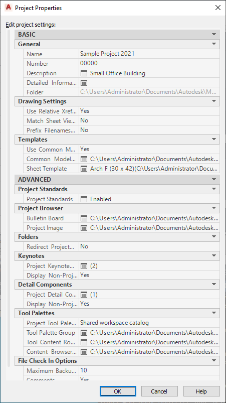

If you have created a project library in Content Browser, you can associate it to a project. When you open the Content Browser from Project Navigator, the project library is automatically displayed.
The project library can be used to drag tools in project drawings, or to fill the project tool palettes with standard tools.
Open
Project.
If you do not explicitly set a location here, the following default behavior is selected depending on how you created your project:

If you select Shared Workspace Catalog, the path selected under Tool Palette File Location is added to the user’s project profile (AWS), and the tool catalog is used from the specified location. If you select Per User Workspace Catalog, a folder is created under \\Documents and Settings\<User Name>\ and the tool palettes are copied to that folder.
