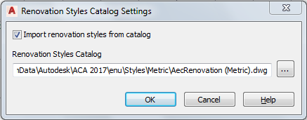

The Renovation styles catalog contains display and layer assignment styles. AutoCAD Architecture 2021 toolset-based styles for objects, such as walls and windows, are managed with Style Manager.
By default, the Renovation styles catalog (AecRenovation.dwg) is installed in ProgramData\Autodesk\ACA <version>\enu\Styles. If the Renovation styles catalog is renamed or moved, the styles are disabled and cannot be accessed. Use the Renovation Styles Catalog Settings dialog box to specify a valid catalog.
Clear the Import renovation styles from catalog checkbox for new drawings to include standard styles only.
