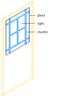

Door muntins are secondary framing members that hold multiple lights in door glass. AutoCAD Architecture 2021 toolset provides an easy way to create muntins with different layout patterns.
Door muntins are available in the following patterns that you can customize into different styles:
Starburst and Sunburst patterns are a combined-rectangular pattern with a half-round or quarter-round spoked top. They can be used for half- and quarter-round door glass as well as rectangular door glass. The other patterns are primarily rectangular but fit into half-round glass. You can make up custom glass shapes by creating profiles from polylines and adding them to a new door style.
Door muntin components
