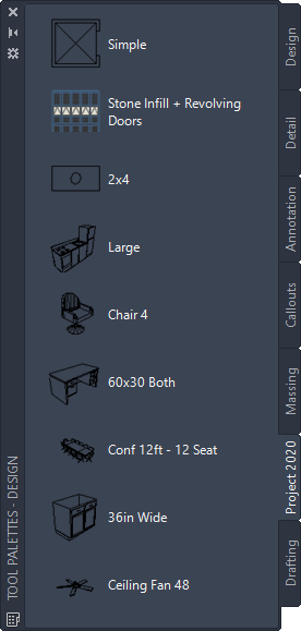

To use a tool catalog item in AutoCAD Architecture 2021 toolset, drag the item into the software’s workspace. Dragging a tool palette into the workspace adds the tool palette to the default tool palette set.
AutoCAD Architecture 2021 Toolset palette, with added tool palette
Once added to the tool palette set, the palette remains a part of the set and is available each time you start AutoCAD Architecture 2021 toolset.
