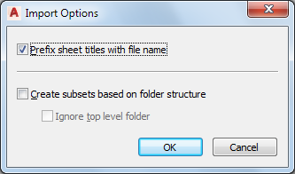

Use this procedure to create a sheet set template that contains layouts from one or more existing drawings. You can also select options to prefix the sheet titles with the file name and create subsets based on the folder structure. Settings applied here are overridden if you redirect top-level categories in the Project Properties dialog box in the project in which the sheet set is located.

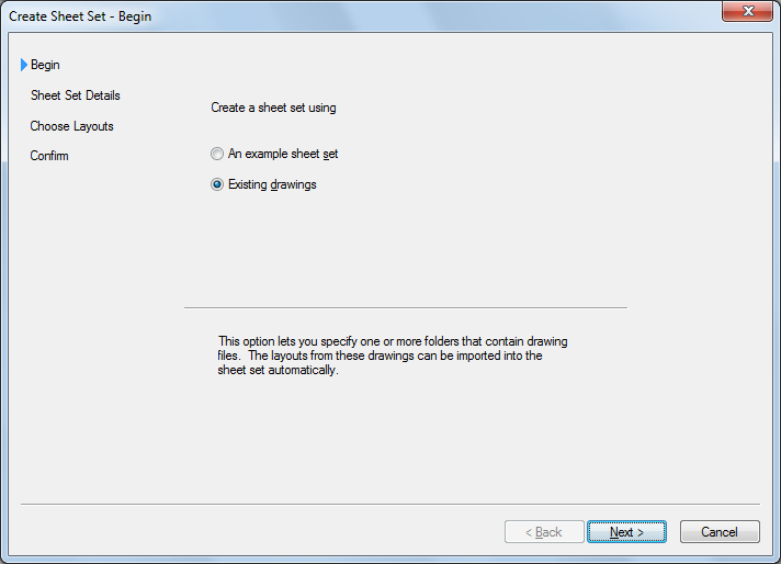

Options. The Create Sheet Set wizard is displayed. It will help you create a new sheet set template.
The sheet set wizard is displayed. It will help you to create a new sheet set template.

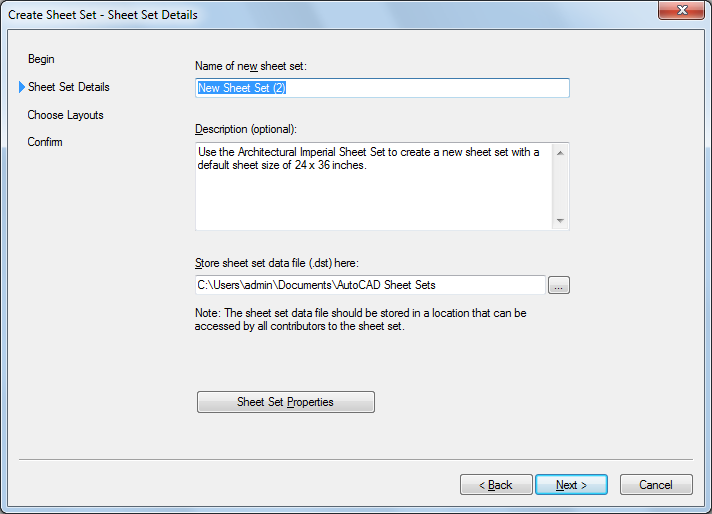

The Sheet Set Properties dialog box is displayed.
It is not necessary to complete the following fields when you use the sheet set template for an AutoCAD Architecture 2021 toolset project:
| Field | Reason |
| Sheet set data file | The DST file is always stored in the root folder of the project. |
| Model view | Model view drawing locations are not tracked in AutoCAD Architecture 2021 toolset sheet sets. They are automatically taken from the project views. In an AutoCAD sheet set, this field displays the paths and names of folders that contain drawings used by the sheet set. |
| Label block for views | These are stored in the view templates. |
| Callout blocks | These are located on the Tools palette. |
| Name, Number, Phase, Milestone under Project Control | You associate project information with the project file (APJ), instead of the project sheet set, when you are working in an AutoCAD Architecture 2021 toolset project. Note: If you enter a project name and project number under Project Control in the Sheet Sets Properties dialog box that differs from the project name and number you entered when you created the project, you will get an error message when editing the project, and be prompted to consolidate the information. Therefore, it is strongly recommended to leave the Project Control fields in the sheet set template empty.
| Sheet storage location | The sheets in a project are always stored in the Sheets folder of the project, or in one of its subfolders. |
None of the other settings under Sheet Set are applied when using the sheet set template for an AutoCAD Architecture 2021 toolset project.
