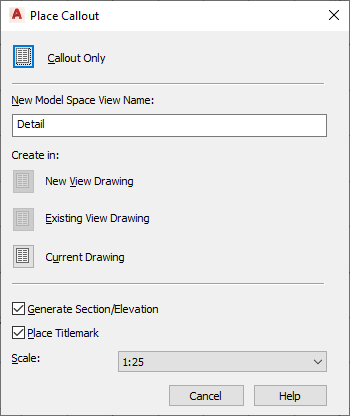

Use this procedure to place a callout that creates a detail in the current view drawing.
Viewing building section detail boundary
| If you want to … | Then … |
| create a callout with a detail boundary and a detail mark | select one of the detail boundary tools. AutoCAD Architecture 2021 toolset provides tools for circular, rectangular, and freeform detail boundaries. |
| create a callout without a detail boundary | select one of the detail mark tools. AutoCAD Architecture 2021 toolset provides tools for regular detail marks, detail marks with a tail, and detail marks with a sheet number attribute. |
Alternatively, you can click
for callouts with a detail boundary, or
for callouts without a detail boundary.
The extents of the model space view will dictate the default sheet view size, so if the model space boundary is too small, you may have problems placing annotations in it.
Once the model space view has been placed in the drawing, the field placeholders in the callout change to a question mark. To resolve them, the model space view needs to be placed onto a sheet.
The model space view is displayed in the Project Navigator under the view drawing in which you have created it.
