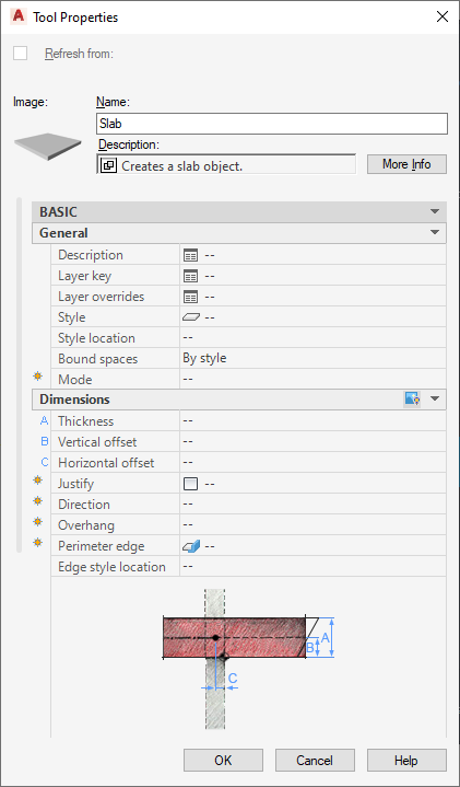

Palette-Based Roof Slab and Slab Tools
To apply a slab edge or roof slab edge style at the time of creation, you can specify them as default properties of a palette-based tool along with other properties:
- You may want to consider “Top”, “Bottom” or “Baseline” justification, depending upon the type of slab and its intended purpose.
- The Vertical Offset can be set to pre-determine an elevation for the slab.
- You can establish an edge style as a default.
Attention: To pre-set the edge style, you must first specify the library drawing in which the edge style exists, then define the edge style to use. Even if the edge style already exists in the current drawing, it will not be used unless you specify the style location.
Slab tool properties, with a slab edge style set as the default.
