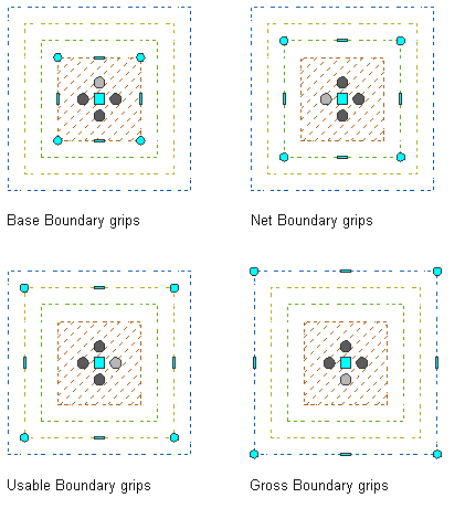

Space Boundaries
Space boundaries are now part of the space object, and not separate objects as they were prior to AutoCAD Architecture 2015. A space has a base boundary, net boundary, usable boundary, and a gross boundary. Space boundaries created in previous versions will be converted to walls when the drawing that contains them is opened in the current version of the software. Managed spaces will be converted to associative spaces. Space boundaries include a number of scheduling properties.
Space boundaries
