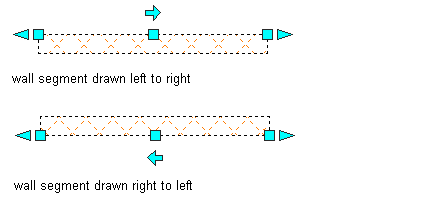

Wall direction is significant for some modifications to walls. Sample wall styles provided with AutoCAD Architecture 2021 toolset were created with the intent that you place perimeter walls in clockwise fashion. After placing a wall, you can determine the wall direction by selecting the wall. The wall direction grip indicates the wall direction. You can also reverse the direction of a wall.
