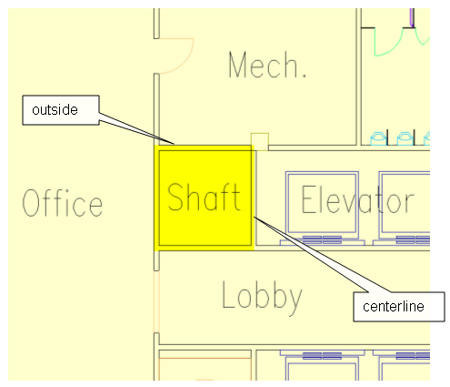

| Usable Area (Space Type_BOMA: MVP) | |
| Adjacent Spaces | Boundary |
| Office, Store, BCA, FCA | Measured from outside face of wall |
| MVP | Measured from centerline of wall |
