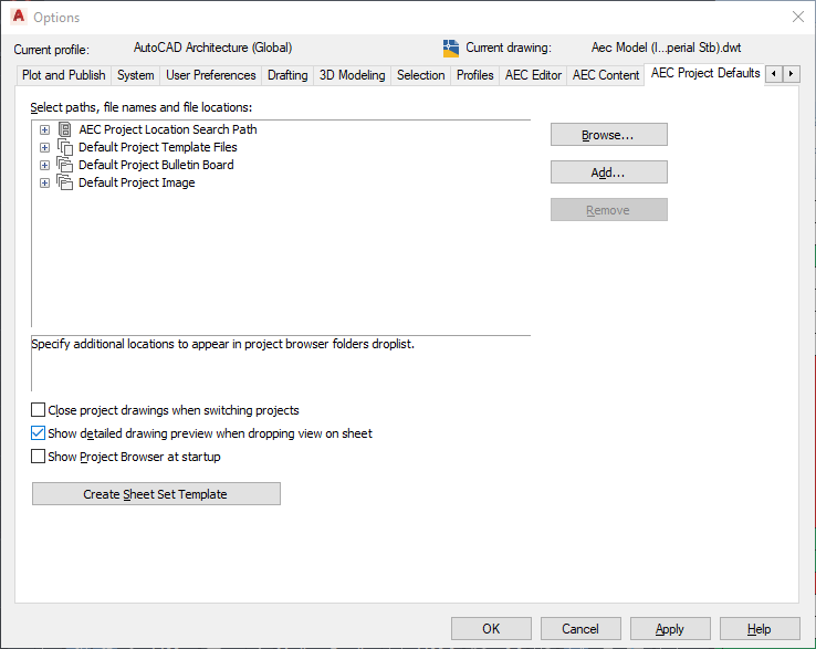

Use this procedure to set the default options for your AutoCAD Architecture 2021 toolset projects. The following options can be specified for projects:
In addition, you can specify settings that affect your workspace when:
Options.
The paths also display in the Project Browser drop-down list (above the list of projects), providing shortcuts to folders containing projects.
| If you want to… | Then… |
| change an existing project location search path | click the path you want to change, and click Browse. In the Browse for Folder dialog box, select the new search path, and click OK. |
| add a search path | click Add. In the Browse for Folder dialog box, select the additional search path, and click OK. |
| remove a search path | click Remove. |
| close all drawing files that are open in your current project when you change to a different project | select Close project drawings when switching projects. This setting is only in effect if the option of Always perform selected action in the Project Browser-Close Project Files dialog box is also selected. |
| improve performance by displaying only the model space view name within the frame of the view when dropping it on a sheet | clear Show detailed drawing preview when dropping view on sheet. |
| specify that the Project Browser opens every time you open AutoCAD Architecture 2021 toolset | select Show Project Browser at startup. |
