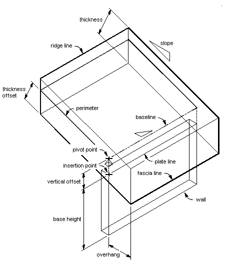

Slab/Roof Slab Bodies
The body of a slab or roof slab is an extrusion perpendicular to the plane of the perimeter and is defined by the following geometry:
Slab/Roof Slab Edges
The following parameters define a slab or roof slab edge:
You apply a fascia and soffit to slab or roof slab edges with styles that define edge conditions

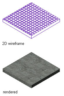

Materials in Slabs and Roof Slabs
You can assign materials to a slab or roof slab. For example, a floor slab can be assigned a material representing tiles with concrete edges. These materials are displayed in wireframe or rendered views. Materials have specific settings for individual components of slabs or roof slabs, such as the body, fascia and soffit.
Slab appearance in different views
AutoCAD Architecture 2021 toolset provides predefined materials for common design purposes. These materials contain settings for slabs or roof slabs that you can use as provided or modify for special designs. You can also create materials from scratch. If you create a material to use only for slabs, name it accordingly; for example, Slab—Ceramic Tile or Slab Edge—Concrete. This will help in organizing your material definitions.
