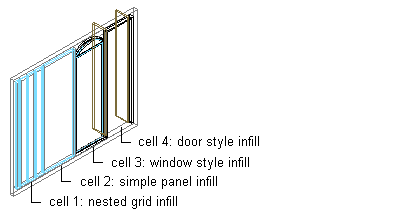

Curtain walls are made up of one or more grids. Each grid in a curtain wall has either a horizontal division or a vertical division, but you can nest the grids to create a variety of patterns from simple to complex.
Curtain wall nested grid example

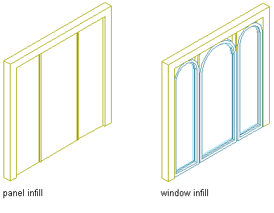

Each cell in a grid can contain either a panel infill, to represent basic cladding materials such as a stone wall panel or glazing, or an object such as a window or a door.
Assigned curtain wall infill types

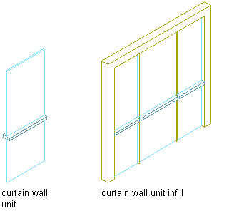

Other objects you can insert in a grid include curtain wall units and door/window assemblies. Curtain wall units are designed to represent complex elements that are repeated within your main curtain wall.
Assigned curtain wall unit infill

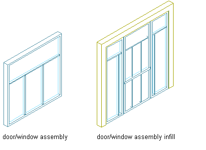

Window assemblies serve a similar function as curtain wall units but can contain panel infills or objects such as doors or windows. Door/window assemblies can be inserted into curtain walls and standard walls.
Assigned door/window assembly infill
Both curtain wall units and door/window assemblies can reduce the need for nested grids, making edits to the curtain wall easier.

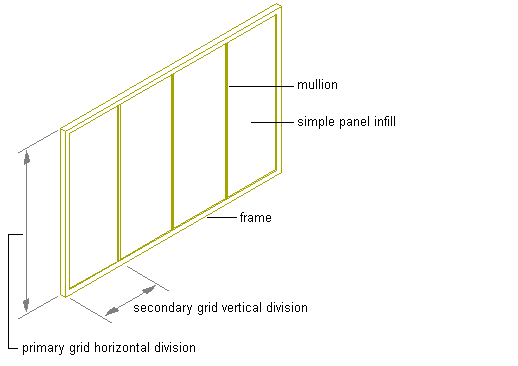

Grids are the foundation of curtain walls, curtain wall units, and door/window assemblies. Every grid has four element types:
Each element type is assigned a default definition that describes what elements of that type look like.
| Element type | Default definitions |
| Divisions | Primary horizontal grid with a fixed cell dimension of 13' and secondary vertical grid with a fixed cell dimension of 3' |
| Cell Infills | Cells containing simple panels 2" thick |
| Frames | Left, right, top, and bottom outer edges of grid 3" wide and 3" deep |
| Mullions | Edges between cells 1" wide and 3" deep |
Specifying grid element types

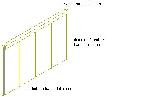

Likewise, you can create multiple frame definitions and then assign a different definition to each frame edge (top, bottom, left, or right). You can also create multiple mullion definitions.
Specifying different frame definitions for each edge of a frame
