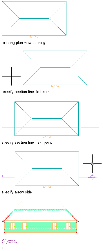

After you draw the section line, you can create a section object or a live section view from the line.
Creating a Section
