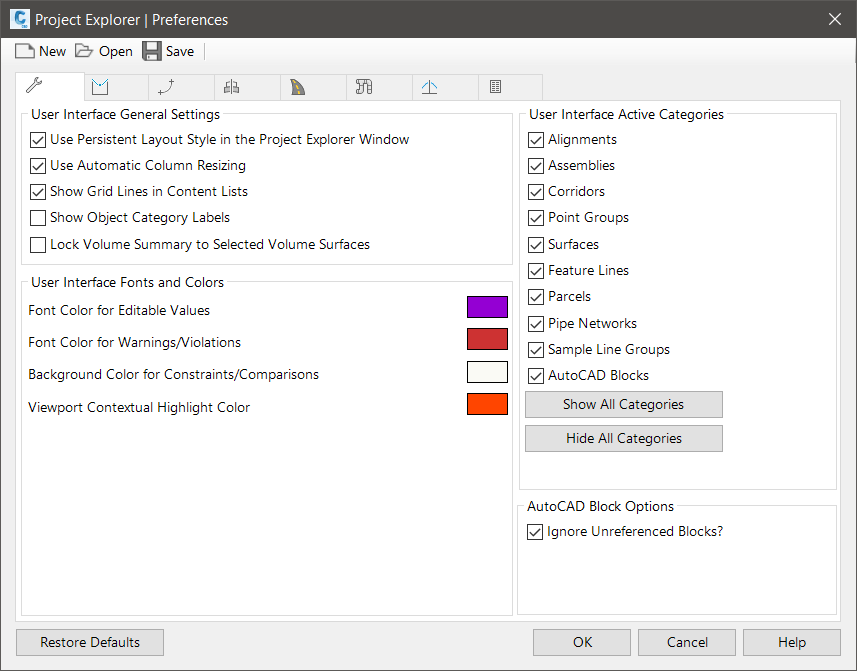

About the General Preferences Tab
User interface general settings
Determines whether the Layout Options assigned to the Project Explorer window are retained between Project Explorer and AutoCAD sessions. If this item is not checked, the layout of Civil 3D content in the Project Explorer window will be reset to the defaults every time a new Project Explorer session is started.
Use automatic column resizing
When checked, the width of each data column is automatically resized to match the width of the column header and column content. If this item is not checked, a default fixed column width is applied which is marginally quicker to redraw on screen.
Show grid lines in contents lists
Determines the style of the Content List Views in the Project Explorer window. Check this item to apply grid lines to all Content List Views.
Show object category labels
Determines whether to show full object category labels on each Object Category Tab in the Project Explorer window, or whether to show Object Category Icons only.

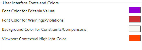

User interface fonts and colors
Font color for editable values
Determines the text color for data columns containing values which can be double-clicked to directly edit the corresponding value in Civil 3D.
Font color for warnings/violations
Determines the text color of any values which are highlighted in the Project Explorer window as violations.
Background color for constraints/comparisons
Determines the background color for data columns which display values from compared or target objects. Compared objects include pipe run comparison surfaces and compared alignments.
Viewport contextual highlight color
Determines the line color for temporarily highlighted points, triangles, or cells in the AutoCAD Viewport when the CTRL button is clicked Project Explorer.

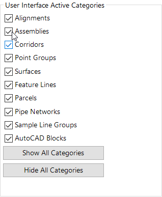

User interface active categories
When undertaking certain tasks in Project Explorer, it is sometimes preferable to disable or hide any Civil 3D Object Categories from the Project Explorer window which are not in use.
These controls allow the visibility of each primary Object Category tab in the Project Explorer window to be set.
AutoCAD block options
Ignore unreferenced blocks
Determines whether unreferenced blocks should be included or excluded from the AutoCAD Blocks list in the Project Explorer window.
