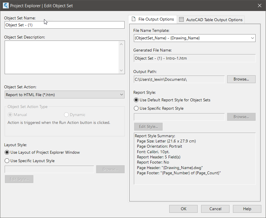

Object Sets can be created from the Create Object Set dialog box, which can be accessed in two ways.
Create Object Set... menu item.
A unique name must be assigned to each Object Set.
An optional description may optionally be assigned to each Object Set.

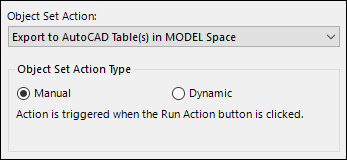

An optional Object Set Action may be assigned to each Object Set. Actions are generally used to automate the process of generating reports, spreadsheets, or AutoCAD tables. The Object Set Action Type parameter determines how the assigned action should be triggered - either manually or dynamically.

There are two different ways in which an Object Set Action can be triggered:
| Type | Description |
| Manual | In this case, actions are triggered manually when the Run Action or Run Actions button is clicked This is the default behavior and is available for all types of Object Set Action. |
| Dynamic | In this case, actions are triggered dynamically when any associated object is modified in the Civil 3D or Project Explorer windows. This action type is currently only Object Set Actions which generate AutoCAD Tables. |

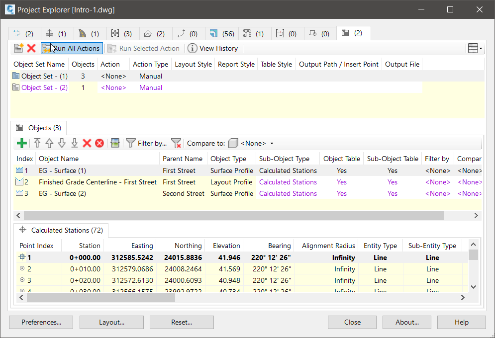

Where the Project Explorer window is not open, any dynamic actions will be triggered when the Project Explorer is next opened. If you are unsure whether a dynamic action has been successfully triggered since a change was made to your design, the Run Action Run All Actions button may be clicked at any time to manually trigger the action.

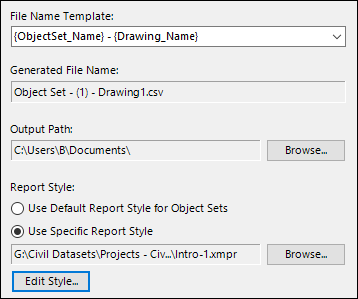

When using the Generate Report action, a Layout Style must be assigned to the Object Set. This Layout Style will determine the layout and formatting of the content in the generated report.
The file name for the report or spreadsheet file can either be typed in, generated from a list of standard variables, or can be created using a combination of the two methods. The drop-down list of variables allows all or part of the filename to be generated from a list of variables such as the selected object name, object set name, the current drawing name, the current date, user name, computer name, and AutoCAD or Project Explorer version.
When using the Generate Report action, an output path must be specified to define where the generated report file should be created.
When variables or combinations of variables are typed into the File Name Template field, the resulting file name is previewed in the field directly beneath it.
A report style is required to define the page size, page orientation, page margins, report header, page header and page footer settings for the generated report or spreadsheet. Click the Browse button to select a previously created Report Style from a file to apply to the generated report or spreadsheet. Alternatively, click the Edit Style button to edit or define a style to use.

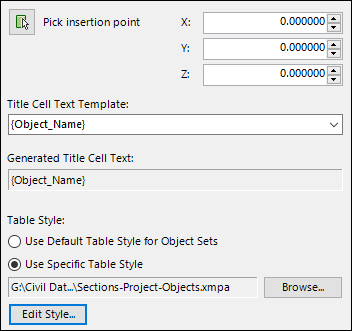

This set of options applies specifically to the creation of static or dynamic AutoCAD tables in model space or paper space.
Use this option to determine the location of the top left corner of the AutoCAD table or tables created by each Object Set. The location can either be specified by typing an XY coordinate into the window, or by picking a point in the AutoCAD viewport.
The text for the title cell of the AutoCAD table can either be typed in, generated from a list of standard variables, or a combination of the two methods. The drop-down list of variables allows all or part of the title cell text to be generated from a list of variables such as the selected object name, object set name, the current drawing name, the current date, user name, computer name, and AutoCAD or Project Explorer version.
When variables or combinations of variables are typed into the Title Cell Template field, the resulting title cell text is previewed in the field directly beneath it.
A Table Style is required to define the border color, font size and type, cell margins, and general visual style of any generated AutoCAD tables. Click the Browse button to select a previously created Table Style from a file to apply to the generated report or spreadsheet. Alternatively, click the Edit Style button to edit or define a style to use.

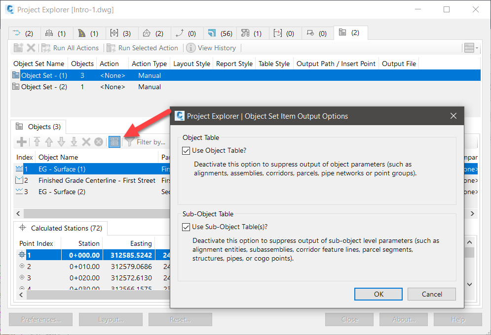

For each item in an Object Set, at least two tables will be written to a table, report, or spreadsheet by default:
With these options you can decide to suppress the creation of either the Object Table or Sub-Object Table. This is useful for situations where you might want to (for instance) create a report or table which includes a list of structures (which would appear in a Sub-object Table), but you do not need to see details of the pipe network (which would appear in the Object Table).

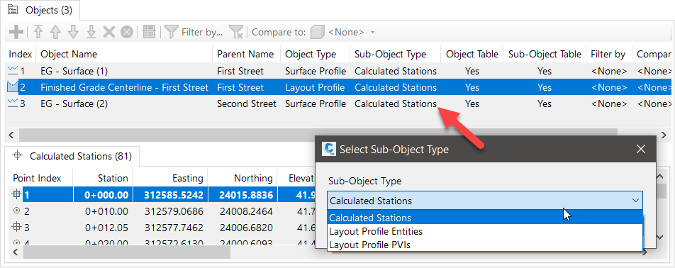

For some Civil 3D object types, there is a choice of available sub-object types for a listed Object Set Item. For example, for alignments it is possible to generate a report which includes calculated stations, alignment entities, alignment PIs, or superelevation critical stations.
For supported object types, the sub-object type can be changed after an object has been added to an Object Set. To change a sub-object type, simply double-click any editable sub-object type and select one of the available items from the list.
