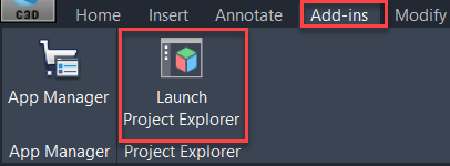

Once installation is complete, the Project Explorer window can be accessed from the Add-ins tab of the main Autodesk Civil 3D ribbon.
Alternatively, ProjectExplorer can be typed at the AutoCAD Command Prompt.
