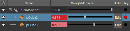

Do the following to add animation to your target layers:
On the Time Slider, drag the time indicator to the desired frame.
In the Shape Editor, drag the Weight/Drivers slider to adjust the object's shape.
Click the red button next to Edit to add a key.
