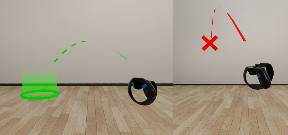

You can teleport instantly from your current position to anywhere else in the level that you can see. This movement mode is great for reaching far-away places quickly, and is typically the main way you'll move from place to place.
Press the Teleport button on either controller. Your laser pointer is replaced by a dashed, curved line. The destination for your teleport is the point where this arc intersects an object in the scene.
Release the teleport button while the end of the arc is a green circle to move to that location.
If the end of the arc is a red X, the destination is unreachable -- typically, this means a surface that is not level enough to stand on.
Note: While editing a level in VR, you can teleport to any surface that is roughly level, regardless of whether that unit has a physics actor. This is different from the runtime teleportation behavior of the Desktop VR project template, in which you can only teleport to a surface if that surface is level and has a physics actor.
