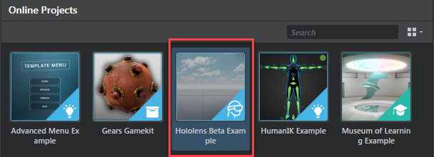

A WIP project for HoloLens testing purposes can be found in the Online Projects tab in the Project Manager.
Note: This project is available only for source code customers.

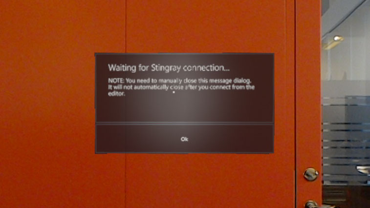

When the app starts up, it shows the following information while it waits for an incoming connection from the interactive editor:
In the interactive editor, use the Connections panel (Window > Deploy and Connect > Connections) to set up the connection to the IP address for the device, then run the project.
For details, see Using the Connections panel.
Note: The engine app on the device must be in this waiting state in order for the editor to initiate a connection. Each time you want to run your project or mirror your viewport, you have to close and restart the engine on the device.
Close the message dialog window on the device manually when connecting to the editor. The window does not close automatically, and while it is visible it hides the 3D content rendered by the engine.
