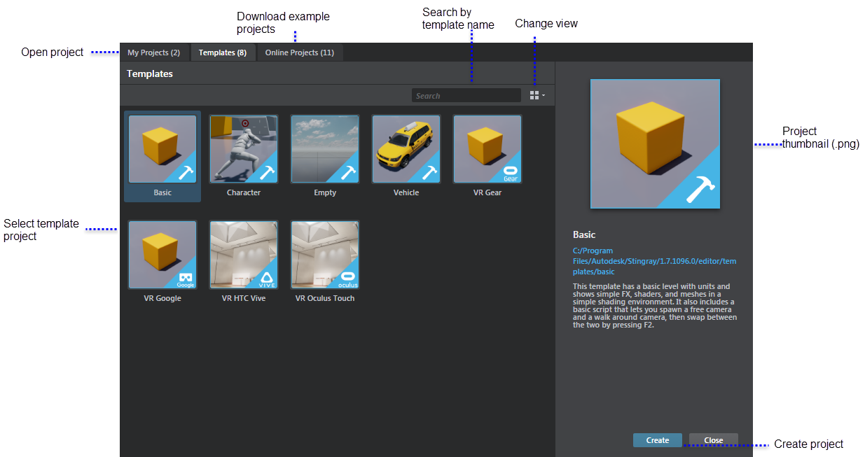

The Project Manager launches automatically each time you start the interactive editor. You can also select File > Project Manager to open the Project Manager.
You can use this window to create and manage your projects, and to download online example projects.
The first task you'll complete in 3ds Max Interactive is to create a project that organizes all the resources that make up your interactive application. Typically, you'll start each new project from one of the template projects available in the Project Manager, or from another existing project. This ensures you always have at least the minimal set of required resources in place when you get started.
