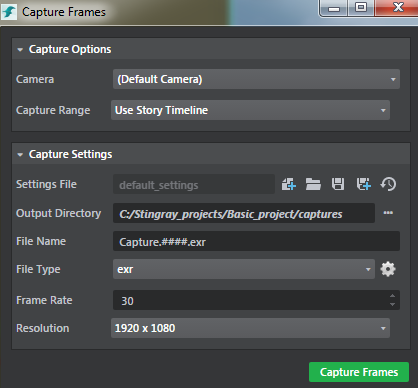

The Capture Frames Tool lets you render frames to disk. The tool is integrated into the Story Editor workflow, and can also be initiated through Flow. For more information on using Flow, see the Capture Frames category in the Flow Node Reference.
The following Capture Settings can be adjusted to control your output. See Capture frames to disk for more information.
Note: Click
in the Story Editor to open the Capture Frames window.
Lets you set a custom range for the camera to capture. Instead of recapturing your entire story after making a change to your animation, specify a Capture Range, and then quickly recapture only those details that need updating. You can select Custom Range - Seconds or Custom Range - Frames. To capture the entire story, select Use Story Timeline.
When setting a range, it is important to remember that your story starts at frame 0. The naming convention for the output EXR files is the same whether you are capturing in frames or seconds. For example, if you want to recapture from frame 3 to frame 8 of your story, File Name_3.exr to File Name_8.exr are output to the selected Output Directory, overwriting the existing files.
You can also capture negative frames, which use following naming convention;The name that is used for each file(s) that is saved. The file name contains #### frame padding to indicate the placement of frame numbers in the output files. You can have a file name with any number of # paddings. Note that there should be at least one number padding in the file name.
The # frame paddings could be in the beginning, middle and the end of the file name. For example, ###Filename.exr would output frames 001Filename.exr, 002Filename.exr, ..,010Filename.exr and so on. If you have multiple # frame padding patterns, the capture engine always uses the last found ## pattern in a name to create the padding. For example My###Filename-####Capture.exr will output the frames as My###Filename-0000Capture.exr, My###Filename-0001Capture.exr, My###Filename-0002Capture.exr and the first left aligned pattern is ignored.Lets you select a file type for your output. Frames are exported using either the PNG format or the OpenEXR format (.exr). The tool delivers three different buffers in OpenEXR when it captures:
Note: The rendered OpenEXR frames uses ZIP compression by default.
Note: Compile the level or press F5 before capturing to take into account the level changes, especially if you add back to the Capture Frames tool a camera previously used for frame capturing and then deleted from the level.
