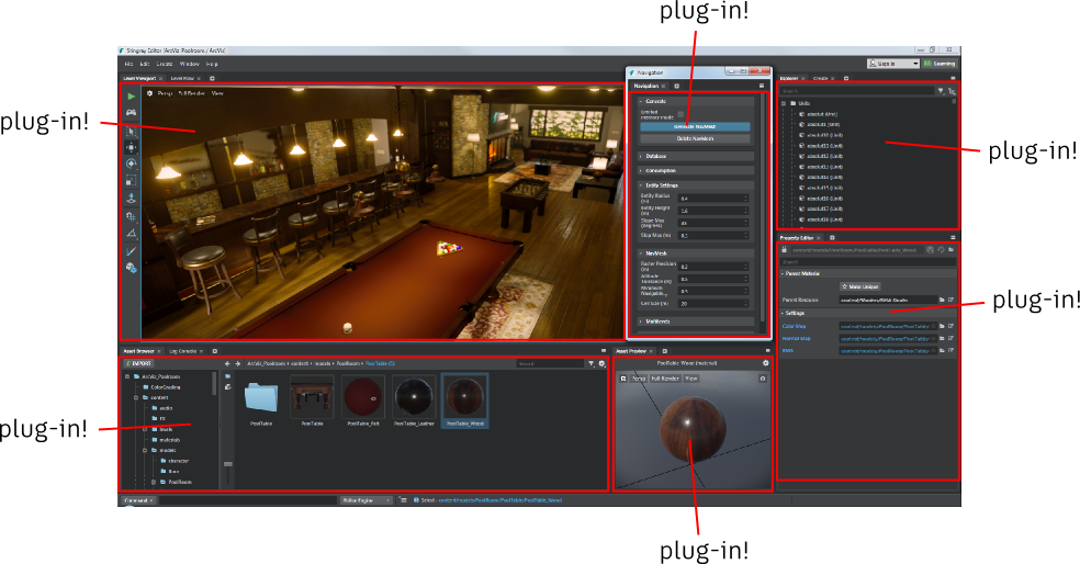

Most of the panels and views that you see in the interactive editor app are actually provided by plug-ins just like the ones you can write yourself:

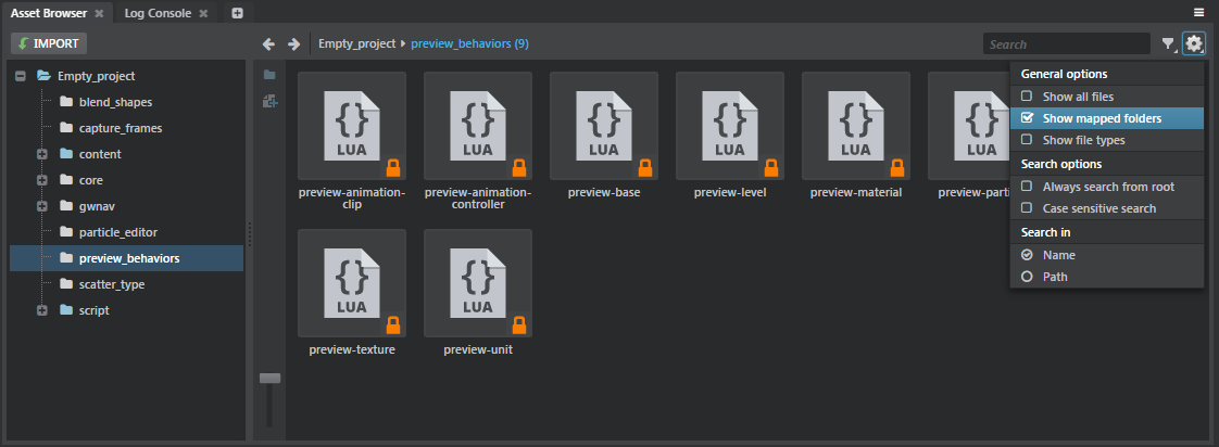

If you choose to Show mapped folders in the Asset Browser, you can see all the asset folders that have been mounted by all of your plug-ins:
