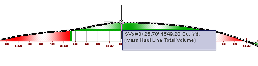

    Notice that the highest point of the green free haul area is at chainage 3+25. This is the gradient point, which is the point at which free haul transitions from cut to fill. Depending on the site conditions, gradient points can be logical locations for dump sites or borrow pits, which can reduce or eliminate overhaul.
  2. At chainage 3+25, hover the cursor over the mass haul line.
    Notice that the tooltip displays the current chainage number (3+25) and volume (approximately 1500.00 Cu. Yd.).

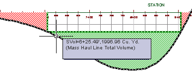

    Notice that this is near the point at which the overhaul volume (in red) and the free haul volume (in green) meet the mass haul line. If you examine this chainage on the profile, you see that it is also a relatively flat section of the existing ground surface. Flat areas can also be good locations for dump sites and borrow pits.
  2. At chainage 6+25, hover the cursor over the mass haul line.
    Notice that the tooltip displays the current chainage number and volume, which is approximately 2000.00 Cu. Yd.
