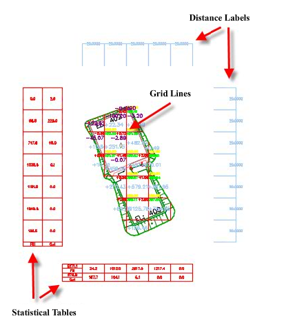

You can use the Earthwork Plan Production command to insert labels in a grid and tables that contain information about the volume of the earthwork between two TIN surfaces. The following illustration shows an example of the grid, labels, and tables that are inserted into a drawing when using this command.

Statistical Table: Displays the total cut and fill values and totals for each row and column of the grid.
Distance Label: Displays the grid interval values.
Grid Line: Displays the grid lines.

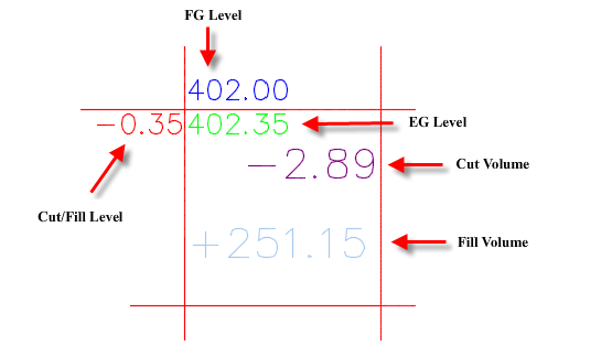

In the Display Settings dialog box, use the options at the top to specify layer, text, and location settings. The following illustration shows how various labels appear in the drawing:

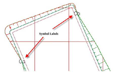

Boundary Point: Specifies that when the shape of a grid cell is irregular, a symbol label is used, the original level labels are used, or no level labels are used.
If you select Symbol Label, symbols are inserted at the locations where cells are irregular and information about those points is inserted into a table in the drawing.
