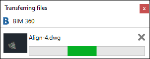

    • After you release your cursor, a message box will be displayed while the documents and folders are being copied.
      Note: Desktop Connector has a Pending Actions window that you can review during this process. For example, when you save a drawing in a BIM 360 project, a Workspace Sync action will be displayed in the Pending Actions window to let you know that the drawing is being uploaded to BIM 360.
