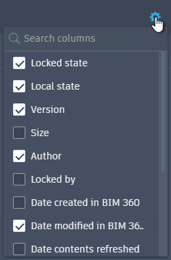

Select Columns
Opens a list for selecting which columns to view in the folder. The available columns are described in the following sections.
Name
Displays the names of the documents and subfolders in the selected folder.
  • Click a subfolder to open it and display its contents in the table.
  • Click a document to open it in Civil 3D.
This column cannot be hidden using the column selector.
Note: Only documents that you can open directly in Civil 3D (DWG, DWT, DXF and DWS) are displayed on this page. You can see other file types by opening the connected drive in Windows Explorer.
Locked State
Displays the locked state of the documents. If the document is not locked, no icon is displayed in the Locked State column.
  • : The drawing is locked by you. When you open a document to edit it, the document is locked and this icon is displayed in the Locked State column.
  • : The drawing is locked by someone else.
  • If the drawing is not locked, no icon is displayed.
Local State
Displays the state of documents on your local connected drive.
  • New: The document is new and has not yet been uploaded to BIM 360. Documents show a state of New when you first save them or copy them to your local connected drive.
  • Online: The document exists in BIM 360 but has not yet been downloaded to the connected drive. Documents are not downloaded to your local drive until you open them in Civil 3D or manually download them by right-clicking a file in Windows Explorer and selecting Sync. When a document is downloaded, it has a Local State of Synced.
  • Synced: The document has been uploaded to BIM 360 and also exists locally.
  • Modified: The document has been modified locally and the changes have not yet been uploaded to BIM 360.
  • Stale: The document has been cached locally, but is not in sync with the latest updated version in BIM 360. This can occur if the document was edited and uploaded to BIM 360 from a different computer. The document will be updated to Synced if you open it or download it.
  • Conflict: The document contains changes both locally and in BIM 360. To resolve this, the next time pending actions are processed, Desktop Connector will move your local changes to the recycle bin and will download the latest version from BIM 360 and the Local State will be changed to Synced.
Note: There is a delay before changes made in the BIM 360 web interface and changes that other team members make to the project documents are reflected in the connected drive. For information about the refresh rates, see Access BIM 360 On Your Desktop in the BIM 360 Help.
Version
Displays the number of times the document has been saved. A document is given the version V1 when it is first uploaded or saved to BIM 360. Saving a document increments the version by one.
Tip: In BIM 360, you can compare versions and restore a previous version. For more information, see Documents in the BIM 360 Help.
Size
Displays the size of the document.
Author
Displays the name of the person who last saved the document.
Locked By
If the document is currently locked, this column displays the name of the person who has locked it.
Date Created in BIM 360
Displays the date and time that the document was saved to or uploaded to BIM 360.
Date Modified in BIM 360
Displays the date and time that the document was last modified and synced to BIM 360.
Date Contents Refreshed
Displays the date and time that the documents were last refreshed from BIM 360 by Desktop Connector.
For information about Desktop Connector refresh rates, see Access BIM 360 On Your Desktop.
Date Permissions Refreshed
Displays the date and time that permissions were last refreshed from BIM 360 by Desktop Connector.
Date Created on Disk
Displays the date and time that the document was first saved or uploaded to the folder.
Date Modified on Disk
Displays the date and time that the document was most recently modified.
Date References Refreshed
Displays the date and time that the files that are referenced by the document were last refreshed from BIM 360 by Desktop Connector.
Date Locked
If the document is currently locked, this column displays the date and time it was locked. If the document is not currently locked, this column does not display a date and time.
Has References
Displays Yes or No depending on whether the document has references to another file such as an xref or a data shortcut.
Refresh Folder
Refreshes the current folder from BIM 360.
More
Displays commands for opening documents. Click the icon and then click Open or Open Read-Only.
