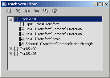

Within the Track Sets Editor dialog, you can browse track set listings, add or remove tracks to/from a track set, highlight track set members based on selections from the Hierarchy list, and vice-versa.
To create a track set from selected tracks:
A new track set appears, containing your selected tracks.
To edit the contents of a track set:
This procedure follows from the previous procedure, and focuses on adding and removing tracks to/from your track set.
The highlighted tracks are now members of your track set.
The highlighted tracks are now removed from the track set.

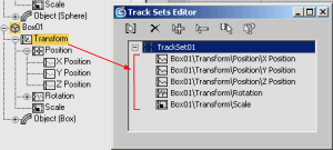

To locate tracks in the Track View or the Track Sets Editor:
This procedure is a continuation of the previous procedures and explains how you can use the Track Sets Editor to quickly locate your tracks in the Hierarchy list and vice-versa. This is useful for managing scenes comprised of many tracks that span across multiple track sets.
In the Track Sets Editor dialog, click
(Highlight Tracks Selected In The Track View).
The common track is highlighted in both track sets.
The respective track in the Controller window is highlighted.
The Track Sets Editor dialog window displays all current track sets. To expand or collapse the track list for a set, click the plus (+) or minus (-), button next to the track set name.

Highlights a track set member based on the current Track View selection. If a track is shared between track sets, all track set members are highlighted.
Highlights a track in the Controller window based on the current track set member selection.
