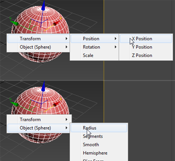

Position
Z Position from the pop-up menu.

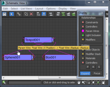

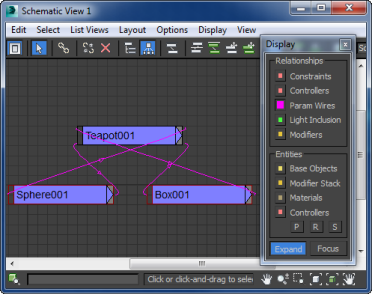

Schematic View opens showing the scene nodes and the Display floater.
Any wires between nodes appear as lines of the same color as the Param Wires button.
The wired relationship appears in a tooltip.

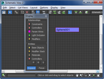

Nothing changes because the parameter wiring is internal to the object. Its internal structure needs to be expanded to see the wiring.
For Schematic View to show such a wire, it's necessary to turn on these Display floater switches, in the Entities group:

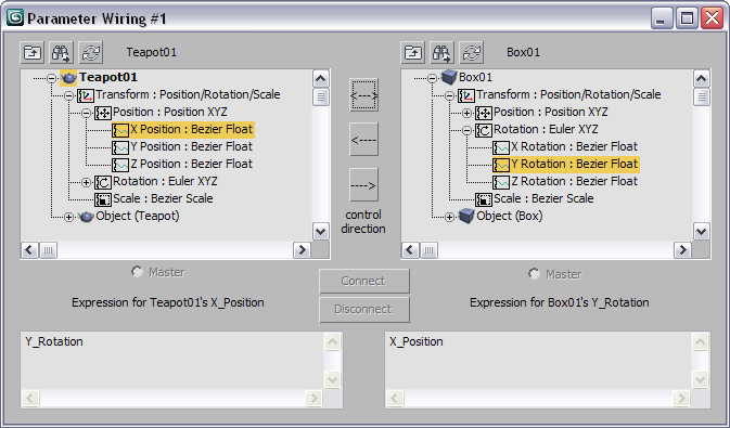

The dialog presents two tree views that display the animatable parameters of all of the visible objects in the scene. The names of the currently selected objects appear at the top. The tree views display the objects in the scene and allow you to select and wire all of the animatable parameters of the objects in the scene and the scene itself.
The tree views are color-coded to show existing wiring. A parameter with a wire controller assigned to it (either as the member of a two-way pair or as the slave in a one-way wire) displays in red. When a wire-controlled parameter is selected, all of the parameters wired directly to it are displayed in green text in the other Tree View. In either case, if the parameter is inside a track that is not expanded, the enclosing track will display in red or green, so you can expand the tracks to find the wires.
The buttons above the tree views are:

Between the tree views are three direction-control buttons. You can choose only one of these at a time. These buttons determine the direction of control, either one-way or two-way:

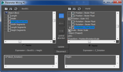

The Connect/Update button changes its label depending on whether clicking it would add a new wire to previously unwired parameters (Connect) or change an existing wire’s expressions or direction (Update). Changes to existing wires are only applied when you click Update.
The Disconnect button is enabled when you’ve selected parameters with an existing wire between them. It will remove the wire controller(s) and replace them with the Master parameter’s animation track (if two-way) or with default controllers (if one-way).
Underneath the parameter trees are the transfer expression windows. These expressions determine how a changes to each parameter affects the other. Usually one expression is the inverse of the other. (You can enter expressions for the two parameters that are not inverses of each other, but this is discouraged because then the result of the wiring will be different depending on which parameter you change first.)
When you first wire the parameters, the default expressions are simple 1-to-1 links between the parameters. You can edit the expressions in these windows. A valid expression yields a result of the correct type for its parameter. For example, if you link a parameter such as height (which contains a float value) to a parameter such as position (which contains a point3 value), your expressions must include conversions that produce the same output value type.

For one-way wires, the expression window for the controlling parameter is unavailable, since there is no Wire controller assigned to it.
For two-way wiring, both transfer expression windows are enabled.
