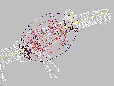

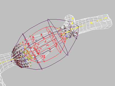

Stray vertices (above) reassigned to correct link(s) by modifying envelope shape (below).

Top: The default envelope from the pelvis to the lower spine object is too small.
Middle: Mesh appears “scrambled” because the pelvis doesn't control all the vertices that surround it.
Bottom: Increasing the envelope size corrects the mesh problem in the pelvis area.
