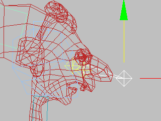

If you want the end of the bone to follow the biped, select the bone and delete the bone end effector in the Motion Panel
This bone is used to animate the character's nose.
