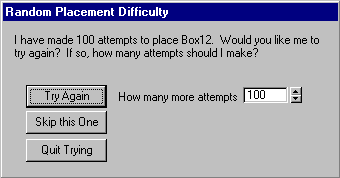

This dialog appears when character studio encounters difficulty placing cloned objects without overlapping using the Scatter Objects dialog. The dialog text tells you how many attempts character studio has made to place a specific object, and asks you if you want to try again.
Click this button to force N more attempts, where N is set in the How Many More Attempts field.
Stops trying to place the current object and proceeds to the next.
Aborts the Generate Locations process; no more objects will be placed.
