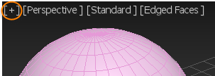

General Viewport Label Menu
Use this menu to adjust general options for viewport display and configuration.
General menu
Note: This menu can be customized. For more information, see the Procedures section below.
