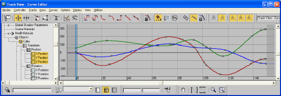

The Curve filters let you apply animation filters to function curves during the export process.

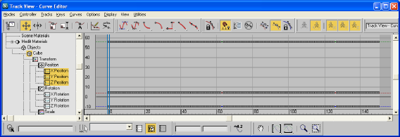

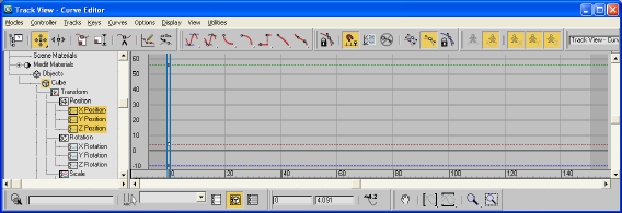

Activate the Constant Key Reducer filter to remove redundant keys. Redundant keys are keys that have the same value, which are equivalent to flat horizontal interpolations on a curve. Redundant keys are often a result of a resampled curve.
Before:
After:

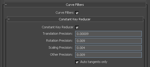

You can set specific thresholds for each type of transform (Transformation, Rotation, Scaling, and Other. Other includes Morph and custom attribute curves, for example).
The default values are:
Values represent generic units. This is why you might need to modify threshold values in relation to the world scale of your scene. This is true for very large or small scale scenes.
If keys are numerically identical, use very small values to ensure that no animation is lost.
If you use this filter to eliminate noise, for example, from motion capture data, then you might need to modify values.
| Setting | Description |
| Translation precision | Threshold for translation curves in generic units. |
| Rotation precision | Threshold for rotation curves in generic units. |
| Scaling precision | Threshold for scaling curves in generic units. |
| Other precision | Threshold for other curves in generic units. |
| Auto tangents only | This option ensures that only “auto” key types are filtered. Otherwise, keys with interpolation values greater than a certain threshold might be deleted. |

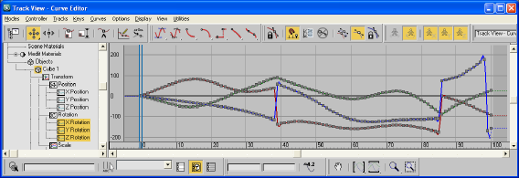

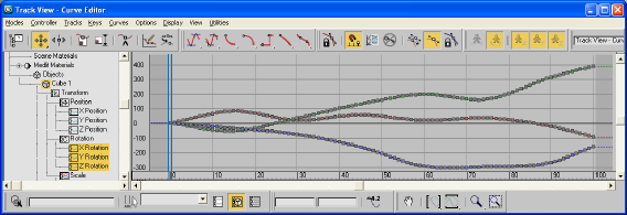

This filter re-evaluates rotation curves to reduce the number of 180' degree rotation jumps for a specified component. You can modify or displace these rotation jumps and/or Gimbal lock with this filter, and not affect the resulting animation visually.
Before:
After:
| Filter precision | The precision value affects how the plug-in re-evaluates the curve and defines the importance given to the unrolled curve. Activate the Unroll Rotations filter to resample rotation curves and give unroll priority and filter intensity to a specific component, X, Y, or Z. |
| Follow Y-up | Activate this option to give priority to the Y component, normally used for Y-up scenes. |
