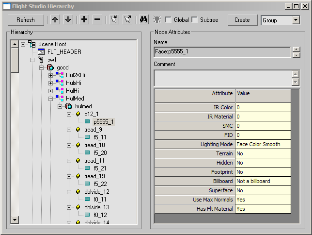

The Hierarchy Browser dialog allows you to arrange, select, and edit the OpenFlight scene and attributes of its nodes.
Controls on the toolbar manage node selection, interact with the current 3ds Max selection set, and let you create new nodes.

On the left side of the Hierarchy Browser dialog, the Hierarchy window displays a list of the nodes in your scene. You can click the plus and minus icons to expand or collapse the list of nodes that have children.
Node names in the Hierarchy window are also their 3ds Max object names.
Node types are visually represented in the hierarchy using the following icons:
The Scene Root has no attributes, and does not respond to drag and drop. It is simply a placeholder to represent the entire scene graph.
The Hierarchy list shows the entire node structure as it was imported from the OpenFlight file.
The scene graph list is formatted to show the parent-child node relationships. Child nodes are always positioned below and indented to the right of their parents. Nodes that are on the same indentation level are considered siblings. If a node contains a small plus or minus (+/-) icon to the left of the node icon, this indicates the presence of children nodes. Clicking on the + or - will cause the list of the node’s children to be expanded or collapsed.
If the Hierarchy list is too long for the window size, then scroll bars will appear on the left or bottom of the Hierarchy window, to let you scroll and view the entire scene graph.
To select a node, click its name. To select more than one node, use Ctrl+click. Clicking a node that is already highlighted deselects it.
You can use drag and drop to change a node’s position in the hierarchy. Select a single node (drag and drop is supported only for a single node), drag its icon to another place in the hierarchy, then release the mouse to drop the node on top of its intended new parent. The node will then be placed at the bottom of the list of the parent’s children.
To change a node name, select a node by clicking its icon, and then click the node name text. This opens an edit box that lets you change the text. When you are done, press Enter or click outside the edit box to confirm the change.
You can use the keyboard arrow keys to change the node selection. First, select a node in the hierarchy. Then press up-arrow or down-arrow to move the selection either up or down.
This group, on the right of the Hierarchy Browser dialog displays information about a node, including the node name, Comments field, and node attributes. You can edit some of this information.
Displays the type of the selected node, and its name. Node names in the Hierarchy Browser are also their 3ds Max object names.
If you have selected multiple nodes, you can use the arrows to the right of this field to scroll among them.
This field is for informational purposes only, and is not editable. You can change a node name by using the Hierarchy window, as described in the previous section.
After you have selected a node, this field displays the text in the node's Comment. You can edit the contents of the Comment: simply type in the changes and then press Enter to confirm the changes.
These columns display each node attribute, on the left, and the attribute’s value, on the right. You can edit attribute values here: click the value itself to open the field for editing.
There are different types of value fields. Some are text-entry fields that require you to tpe in an explicit numeric value or string. Others have a drop-down list so you can choose from a set of predefined values.
Whether the attribute requires you to type in an entry or choose from a list, after you have changed the value, press Enter to confirm the change.
