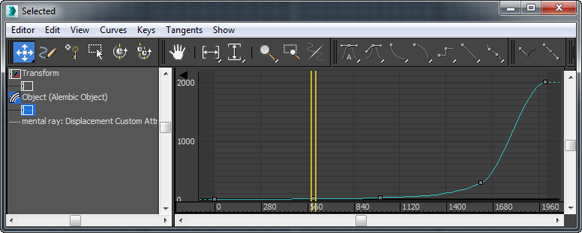

You can use the Playback Type
Playback Graph option to vary the playback rate of an Alembic animation.
Modify panel.
Playback Type group, choose Playback Graph from the drop-down list.
. This alters the mapping between the Alembic animation and the animation in 3ds Max.
