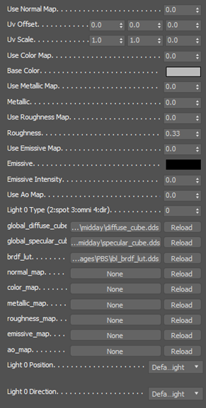

On the Material Editor, the Parameters rollout for the current Interactive shader lets you change settings without altering the shader graph.
Note: In 3ds Max 2018.4 Update, the Stingray physically-based shader is renamed
Interactive.
When you edit the shader graph, controls on the Parameters rollout update to reflect the current graph.
Parameters rollout for the default preset Interactive shader
