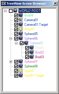

RESULT:

fn initTreeView tv ilTv =
This is the existing TreeView initialization function, but this time it gets a second argument, which will be the ImageListCtrl ActiveX control responsible for the icon management.
tv.Indentation = 28*15
tv.LineStyle = #tvwRootLines
tv.checkboxes = true
This time, we will want to have checkboxes in front of every node. They will be used to display and control the Hidden state of the scene nodes.
tv.sorted = true
We also want the tree to be alphabetically sorted.
ilTv.imagewidth = 16
ilTv.imageheight = 15
We define the size of the icon image to be the same as the icon we are going to grab from the icons file.
iconDir = (getDir #ui) + "\\icons"
This is the default location of the shipping icon files.
ilTv.listImages.add 1 #root (loadPicture (getIconFromBitmap (iconDir + "\\Standard_16i.bmp") 2))
We call the .add() method of the .listImages property of the ImageListCtrl which is used to manage the icons. The first image we add will be used for the root node only. We call the getIconFromBitmap function we defined earlier and pass the icon file containing Standard geometry primitives and the icon number 2 (Sphere). The resulting path is passed to the loadPicture method which opens the temporary icon .bmp file and assigns the resulting OLE-capable icon image to the ImageListCtrl.
ilTv.listImages.add 2 #geomnode (loadPicture (getIconFromBitmap (iconDir + "\\Standard_16i.bmp") 1))
We repeat the whole again, but this time we create the image number 2 which will be used for geometry nodes. We grab icon number 1 (Box).
ilTv.listImages.add 3 #light (loadPicture (getIconFromBitmap (iconDir + "\\Lights_16i.bmp") 3))
Same for the third image which will be used for light, but we ask for the third icon of the Lights icons file (Omni).
ilTv.listImages.add 4 #camera (loadPicture (getIconFromBitmap (iconDir + "\\Cameras_16i.bmp") 2))
The camera will be image number 4. We grab the second icon from the Cameras icons library.
ilTv.listImages.add 5 #helper (loadPicture (getIconFromBitmap (iconDir + "\\Helpers_16i.bmp") 1))
Finally, we define a fifth image which grabs the first icon from the Helpers icons file (Dummy).
There are some more classes that were not defined yet (Shapes, Space Warps), you can try to implement your own icons in the same way by extending the above code!
tv.imageList = ilTv
At the end, we assign the ImageListCtrl Control to the .imageList property of the TreeView. This makes all the above images available as icons in the TreeView control!
fn addChildren tv theNode theChildren =
for c in theChildren do
theIcon = case superclassof c of
Now that we have icons in the control, we can check the superclass of the 3ds Max scene node being processed by the function and define the right icon based on the type. The variable theIcon will contain an integer corresponding to the icon to be used.
GeometryClass: 2
Geometry objects will use image 2 as icon,
Light: 3
Lights will use image 3,
Camera: 4
Cameras will use image 4,
Helper: 5
Helpers will use image 6,
Default:2
All others will use the Geometry icon until they get their own icons.
newNode = tv.Nodes.add theNode.index 4 "" c.name theIcon
Instead of setting the icon index to 0 as we did in Part One, we set the icon to the value defined above...
theNode.sorted = true
We wanted all levels of the hierarchy to be sorted alphabetically.
newNode.checked = not c.isHidden
The checked state of the node will be the inverse of the .isHidden property (which is true when the node is hidden). Since we want to check the box when the node is NOT hidden, we tell exactly this...
newNode.forecolor = color c.wirecolor.b c.wirecolor.g c.wirecolor.r
Since we have complete control over the color of each node in the TreeView, why not grab the color of the wireframe display and assign to the .forecolor property? This gives us a colorful reference to the color of the scene objects!
You could enhance this to grab the diffuse color of the material in the cases where the object has a Standard material assigned, or use the color to represent some other property... In addition, you could also set the .bold property of the TreeView node to true to represent some other property of the 3ds Max objects...
addChildren tv newNode c.children
fn fillInTreeView tv =
theRoot = tv.Nodes.add()
theRoot.image = 1
We already defined the first image of the ImageListCtrl to show a sphere icon. We will use it to represent the root node.
theRoot.text = "WORLD ROOT"
rootNodes = for o in objects where o.parent == undefined collect o
addChildren tv theRoot rootNodes
activeXControl tv "MSComctlLib.TreeCtrl" width:290 height:490 align:#center
activeXControl ilTv "MSComctlLib.ImageListCtrl "height:0 width:0
This is the ImageList ActiveX Control used by the TreeView to manage its icons. It needs no rollout representation - we set the height and width to 0.
on tv NodeCheck theNode do
If the user changed the state of the checkbox of a node...
theSceneNode = (getNodeByName theNode.text)
...we try to figure out which scene node it represents by converting the text label to the actual object name...
if theSceneNode != undefined do
...and if the attempt was successful,
theSceneNode.isHidden = not theNode.checked
...we set the .isHidden property of the scene node to the inverted value of checked state of the TreeView node. If the user unchecked the checkbox, theNode.checked will return false, which will be converted to true by not and assigned to the hidden property, effectively hiding the node!
on tv nodeClick theNode do try(select (getNodeByName theNode.text))catch()
on treeview_rollout open do
fillInTreeView tv
try(destroyDialog treeview_rollout)catch()
createDialog treeview_rollout 300 500
