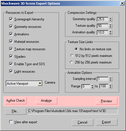

<void>s3dexporter.preview()
Corresponds to pressing the Preview button in the Shockwave 3D exporter dialog, creating a preview of the scene to be exported to Shockwave 3D.
<void>s3dexporter.analyze()
Corresponds to pressing the Analyze button in the Shockwave 3D exporter dialog, performing analysis and displaying statistics about the scene to be exported to Shockwave 3D.
<void>s3dexporter.authcheck()
Calling this method corresponds to pressing the Author Check button in the Shockwave 3D exporter dialog.
